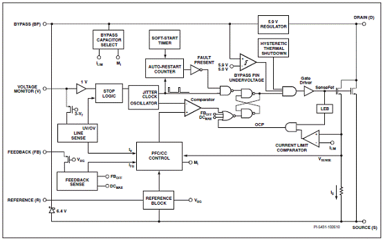

LinkSwitch-PH LED Driver IC Family
Single-Stage PFC, Primary-Side Constant Current Control and TRIAC Dimming/Non-Dimming Options
The LinkSwitch-PH dramatically simplifies implementation of LED drivers requiring long lifetime, high efficiency, PF >0.9, and TRIAC dimming capability (LNK403-410). The single-stage combined power factor and constant-current controller eliminates a switching stage and the electrolytic bulk capacitor. The advanced primary-side control used by the LinkSwitch-PH device provides accurate constant current control while eliminating the need for an optocoupler and current sensing circuits.
LinkSwitch-PH incorporates a 725 V power FET, a continuous-mode PWM controller, a high-voltage switched current source for self biasing, frequency jittering, protection circuitry including cycle-by-cycle current limit and hysteretic thermal shutdown.

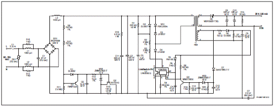

Schematic of an Isolated, TRIAC Dimmable, High Power Factor, Universal Input, 14 W LED Driver.

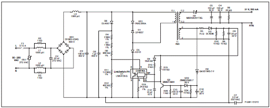

Schematic of an Isolated, Non-Dimmable, High Power Factor, Universal Input, 7 W LED Driver.

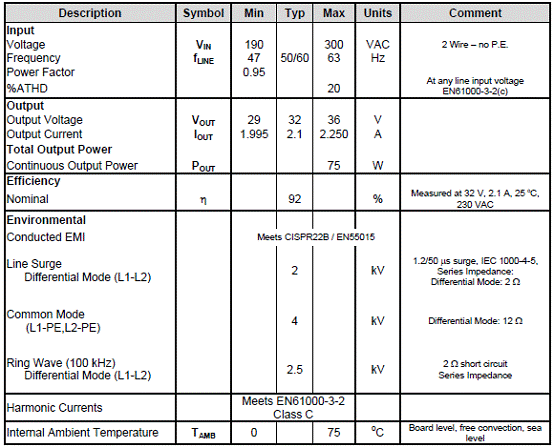

Reference Design Report for a >92% Efficient 75 W Power Factor Corrected LED Driver Using LinkSwitchTM-PH LNK420EG
This document is an engineering report describing an isolated LED driver (power supply)utilizing a LNK420EG from the LinkSwitch-PH family of devices.
The RD-290 provides a single constant current output of 2.1 A over an LED string voltage of 29 V to 36 V in a highly efficient, simple and low component count design.
The board was optimized to operate over the high AC input voltage range (190 VAC to 300 VAC, 47 Hz to 63 Hz). LinkSwitch-PH based designs provide a high power factor(>0.95) with low harmonic current content, easily meeting international limits.

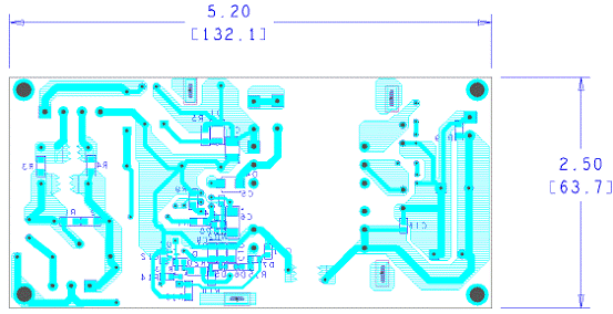

The form factor of the board was chosen to illustrate the simplicity of fitting into standard down light applications.
The document contains the power supply specification, schematic, bill of materials,transformer documentation, printed circuit layout, and performance data.
Summary and Features
 Single-stage combined power factor correction and accurate constant current (CC) output
 Low cost, low component count and small PCB footprint
 Highly energy efficient, >92 % at 230 VAC input; 36 V LED
 Fast start-up time (<300 ms) – no perceptible delay
 Integrated protection features
Single shot no-load latching protection / output short-circuit protected with auto-recovery
 Auto-recovering thermal shutdown with large hysteresis protects both components and printed circuit board
 No damage during brown-out conditions
 PF >0.95 at 230 VAC
 Meet Class C Harmonics Limits EN61000-3-2
 Meet EN55015 conducted EMI
 %A THD <20% at 230 VAC
 Meets IEC ring wave (2.5 kV), differential line surge (2 kV), common mode line surge (4 kV) and EN55015 conducted EMI

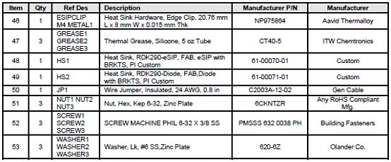

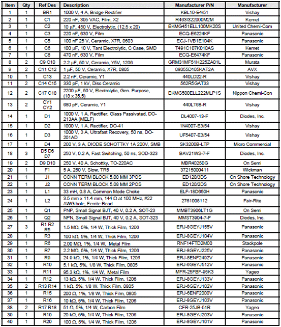

Mechanical Bill of Materials

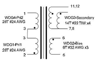

Transformer Electrical Diagram
