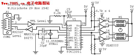

AT89C2051驱动步进电机的电路和源码
发布时间:2011-6-22 11:46    发布者:circuit_share
关键词: AT89C2051 , 步进电机
程序
stepper.c
stepper.hex
* STEPPER.C
* sweeping stepper's rotor cw and cww 400 steps
* Copyright (c) 1999 by W.Sirichote
#include c:\mc51\8051io.h /* include i/o header file */
#include c:\mc51\8051reg.h
register unsigned char j,flag1,temp;
register unsigned int cw_n,ccw_n;
unsigned char step[8]={0x80,0xc0,0x40,0x60,0x20,0x30,0x10,0x90}
#define n 400
/* flag1 mask byte
0x01 run cw()
0x02 run ccw()
main()
flag1=0;
serinit(9600);
disable(); /* no need timer interrupt */
cw_n = n; /* initial step number for cw */
flag1 |=0x01; /* initial enable cw() */
while(1){
tick_wait(); /* wait for 10ms elapsed */
energize(); /* round-robin execution the following tasks every 10ms */
cw();
ccw();
cw(){
if((flag1&0x01)!=0)
cw_n--; /* decrement cw step number */
if (cw_n !=0)
j  ; /* if not zero increment index j */
else
{flag1&="0x01; /* disable cw() execution */
ccw_n = n; /* reload step number to ccw counter */
flag1 |=0x02; /* enable cww() execution */
ccw(){
if((flag1&0x02)!=0)
ccw_n--; /* decremnent ccw step number */
if (ccw_n !=0)
j--; /* if not zero decrement index j */
else
{flag1&="0x02; /* disable ccw() execution */
cw_n = n; /* reload step number to cw counter */
flag1 |=0x01; /* enable cw() execution */
tick_wait(){ /* cputick was replaced by simpler ASM code 10ms wait */
asm' JNB TCON.5,*'; /* wait for TF0 set */
asm' CLR TCON.5'; /* clear TF0 for further set */
asm' ORL TH0,#$DC'; /* reload TH0 with $DC, TL0 = 0 */
energize(){
P1 = step[(j&0x07)]; /* only step 0-7 needed */
