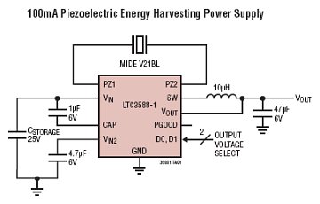

                           图1 典型应用

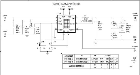

The  circuit  is  an  energy  harvesting  power supply  featuring  the LTC3588-1/LTC3588-2.
An ultralow quiescent current undervoltage  lockout mode with a wide hysteresis window  allows charge to accumulate on an input capacitor until the buck converter can efficiently transfer a portion of the stored charge to the output. Four output  voltages are pin selectable with up to 100mA of continuous  output current. A power good comparator produces a logic high referenced to VOUT on the PGOOD pin when the converter reaches the programmed VOUT, signaling that the output is in regulation.
A power good comparator produces a logic high referenced  to VOUT on the PGOOD pin the first time the converter reaches the programmed VOUT, signaling that the output is in regulation. The PGOOD pin will remain high until VOUT falls to 92% of the desired regulated voltage.
方案原理图:
