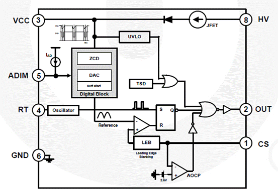

图1.FL7701方框图

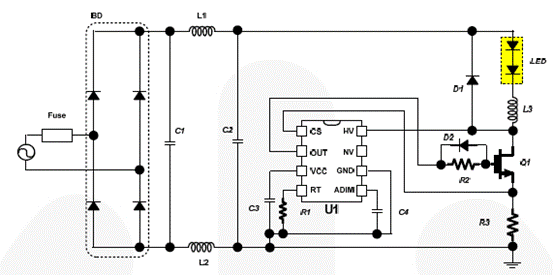

图2.FL7701典型应用电路图

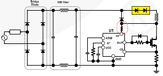

图3.FL7701高压应用电路图

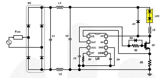

图4.FL7701无电解电容的应用电路
图5.FL7701带电解电容的应用电路

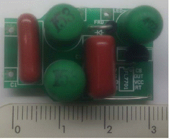

采用FL7701的2.4W LED镇流器

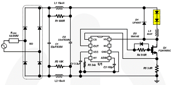

This document describes the proposed solution for a universal-input 2.4W LED ballast using the FL7701. The input voltage range is 90VRMS – 265VRMS and there is one DC output with a constant current of 85mA at 28VMAX. This document contains general description of FL7701, the power supply specification, schematic, bill of materials, and the typical operating characteristics.
图6.2.4W LED镇流器外形图
图7.2.4W LED镇流器电路图

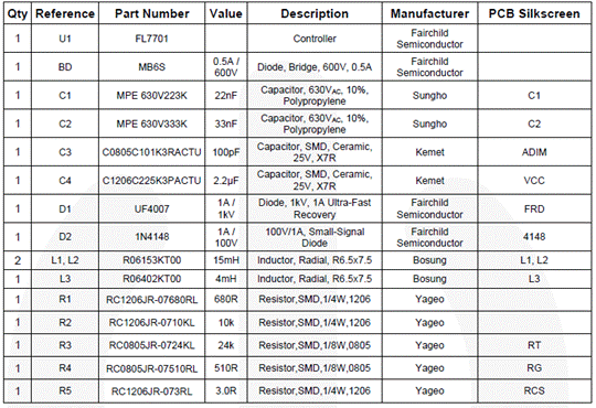

2.4W LED镇流器材料清单:
