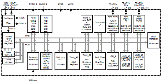

图1. MSP430F471x7方框图
图2. MSP430F471x6方框图
图3. MSP430F471x3方框图

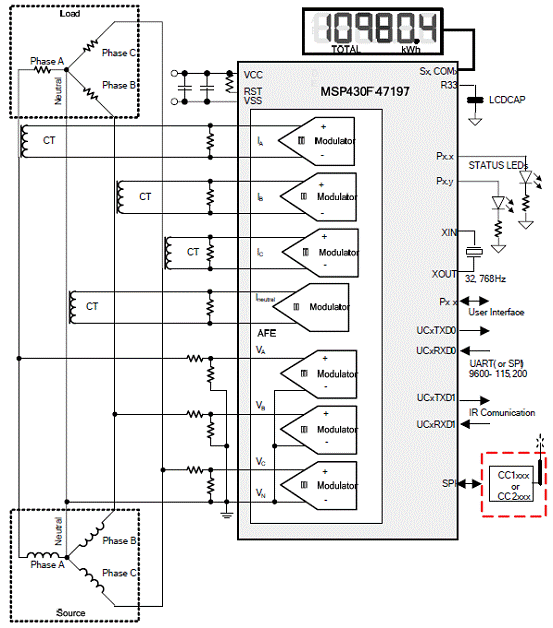

采用MSP430F471xx的三相电度(瓦特-小时)表
This application report describes the implementation of a three phase electronic electricity
meter using the Texas Instruments MSP430F471xx system-on-chip (SOC) processor.
This application report includes the necessary information with regard to metrology software, hardware and calibration procedures for this single chip implementation. Results are included at the end, which show performance of this device for three phase using current transformers as sensors.
图4.采用MSP430F47197的三相四线星形连接的电度表框图

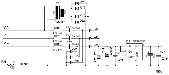

图5. MSP430电表的容性电源电路
图6. MSP430电表的基于变压器电源电路图

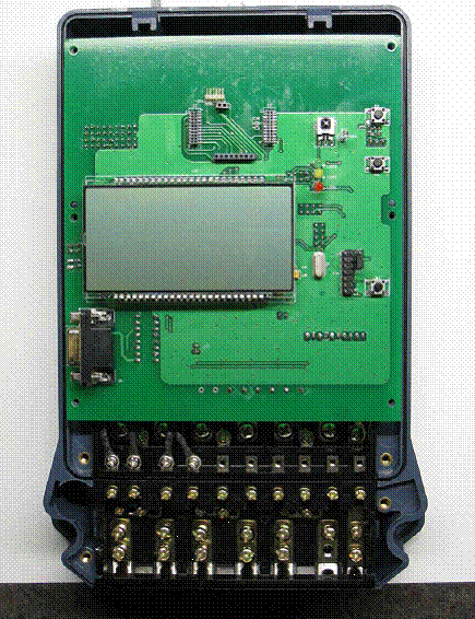

图7.三相电表EVM外形图

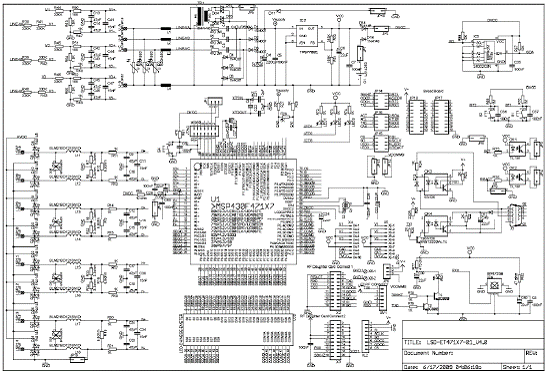

图8.三相电表EVM电路图
