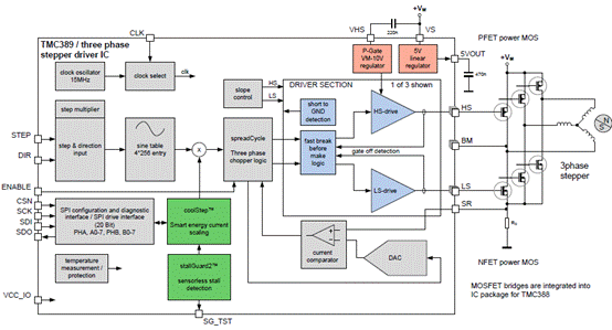

TRINAMIC ¹«Ë¾µÄTMC389ÊÇÈýÏಽ½øÂí´ïÇý¶¯Æ÷,¼¯³ÉÁ˵ÍгÕñµÄÈýÏàÕ¶²¨Æ÷ÓÃÓÚ¾²Ì¬Âí´ï¹¤×÷,ÄÜÖ±½ÓÇý¶¯Èý¸öÍâ½ÓN/P¹µË«MOSFET,Âí´ïµçÁ÷¸ß´ï8AºÍ60V,¶à´ï171¸ö΢²½¾à,²ÉÓûùÓÚ×Ô¶¯¸ºÔص÷ÕûÂí´ïµçÁ÷µÄcoolStep™s20,½ÚÄܸߴï75%,Ö÷ÒªÓÃÔÚ¾«ÃÜÈýÏಽ½øÂí´ïÇý¶¯,Ò½Áƺ͹âѧӦÓÃ,»úÆ÷È˺ÍÎę̀ÕÕÃ÷.±¾ÎĽéÉÜÁËTMC389Ö÷ÒªÌØÐÔºÍÓÅÊÆ,·½¿òͼºÍÓ¦Óõç·ͼ,ºÍ¸ßѹ´óµçÁ÷¹¦Âʼ¶µç·ͼÒÔ¼°ÆÀ¹À°åTMC389¨CEVALÖ÷ÒªÌØÐÔ,Ó¦Óÿòͼ,µç·ͼºÍPCBÔª¼þ²¼¾Öͼ.
The TMC389 is an energy efficient three phase stepper motor driver for high resolution microstepping applications. It integrates a low resonance three phase chopper for quiet motor operation. Its step and direction interface allows simple use. An SPI™ management interface allows for parameterization and diagnostics. The TMC389 directly drives 3 external N/P channel dual MOSFETs for motor currents up to 8A and up to 60V. Protection and diagnostic features further reduce system cost and increase reliability.
TMC389²úÆ·ÁÁµã:
 Up to 171 microsteps (256 sine wave steps) using step/direction interface or 20 Bit SPI™interface
 High precision sensorless motor load measurement stallGuard2
 Energy efficiency and coolness by automatic load dependant motor current regulation coolStep™s20 : Save up to 75% of energy!
 Internal microstep extrapolation allows 256 wave step smoothness with low frequency step input
 Dual edge step option allows half step frequency requirement, e.g. for opto-couplers
 Up to 8A Motor current using external N&P channel MOSFET pairs
 Synchronous rectification reduces transistor heating
 9V to 60V operating voltage (peak)
 3.3V or 5V interface
 QFN32 package for extremely small solution with superior thermal performance
 EMV optimized current controlled gate drivers ¨C up to 45mA gate current
 Overcurrent, short to GND and overtemperature protection and diagnostics integrated

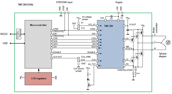

ͼ1.TMC389»ù±¾Ó¦Óÿòͼ

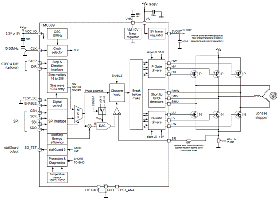

ͼ2.TMC389·½¿òͼºÍÓ¦Óõç·ͼ

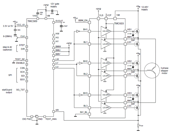

ͼ2.TMC389²ÉÓÃÍâ½ÓÕ¤¼«Çý¶¯Æ÷µÄ¸ßѹ´óµçÁ÷¹¦Âʼ¶µç·ͼ

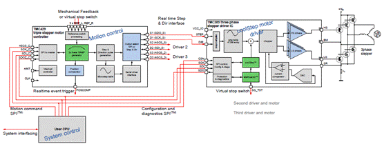

ͼ2.TMC429 StepDir¿ØÖÆÆ÷ºÍSPI»¥Á¬µÄʾÀýͼ

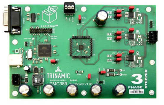

TMC389ÆÀ¹À°å
The TMC389 evaluation board features a TMC389 with external power MOSFETs plus a microcontroller, which allows interfacing to a PC for visualization and control of all parameters. The motor can be operated via the step and direction interface, using either an external source, or using the integrated microcontroller as a step pulse generator.
The TMC389-EVAL allows you to explore all functions of the TMC389. The evaluation board comes with a PC software which gives you access to every function of the driver. It comes along with a Step&Direction interface, a RS232 and a USB port. The TMC389-Eval is a complete "plug and play" solution, additionally only a motor, a PC and a power supply are required!
TMC389ÆÀ¹À°åÁÁµã:
 Evaluate all features of the TMC389
 Use stallGuard2™ with your motor
 Use coolStep™ with your motor
 Control all parameters from a PC
 Motor current can be set to up 6A depending on sense resistor selection.
 Supply voltage up to 40V (MOSFETs can be exchanged against 60V 2A types)
 Access all pins of the TMC389

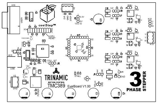

ͼ3.TMC389-EVALÆÀ¹À°åÍâÐÎͼ
ͼ4.TMC389-EVALÆÀ¹À°åÓ¦Óÿòͼ
ͼ5.TMC389-EVALÆÀ¹À°åÔª¼þ²¼¾Öͼ

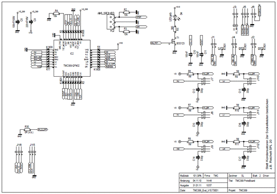

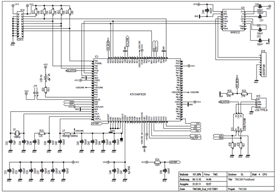

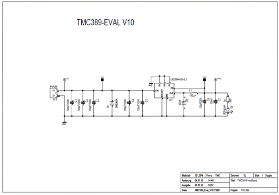

ͼ6.TMC389-EVALÆÀ¹À°åµç·ͼ(1)
ͼ7.TMC389-EVALÆÀ¹À°åµç·ͼ(2)

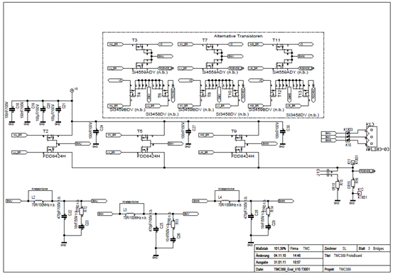

ͼ8.TMC389-EVALÆÀ¹À°åµç·ͼ(3)
ͼ9.TMC389-EVALÆÀ¹À°åµç·ͼ(4)
