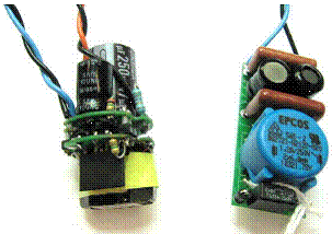

图1.EMI板和降压-升压板外形图

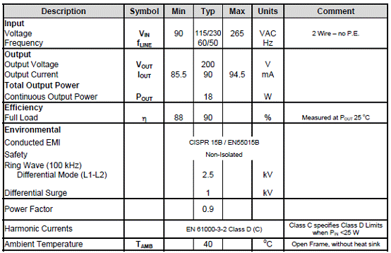

18W T8管灯LED驱动器(DER298)主要特性:
 Designed for linear fluorescent LED tube retro fit applications
 Compact, low component count design – fits into ends of tube enclosure
 Frequency jitter for smaller, lower cost EMI filter components
 Excellent line and load regulation, <2% typical
 Highly energy efficient
 ≥89.5% at 110 VAC
 ≥90% at 230 VAC
 Power factor corrected
 PF >0.93 across line and load, EN61000-3-2(c) compliant
 A-THD <28% (230 VAC), <20% (115 VAC)
 Integrated protection and reliability features
 Output short-circuit protected with auto-recovery
 Line input overvoltage shutdown extends voltage withstand during line faults.
 Auto-recovering thermal shutdown with large hysteresis protects both components and
printed circuit board
 IEC 61000-4-5 ring wave and surge and EN55015 B conducted EMI compliant 18W T8管灯LED驱动器主要指标:

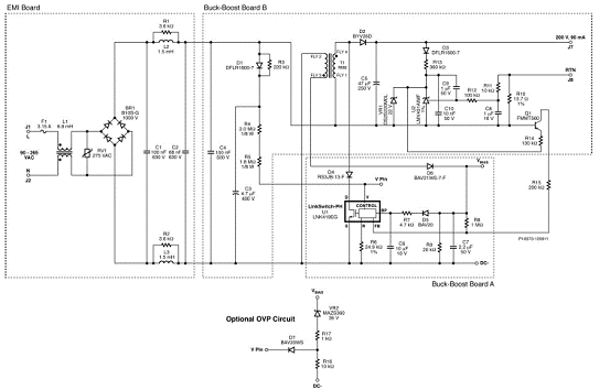

图2.18W T8管灯LED驱动器电路

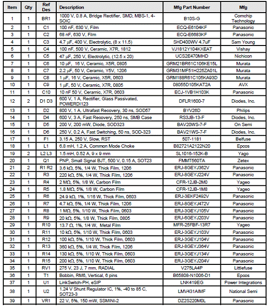

18W T8管灯LED驱动器材料清单:
