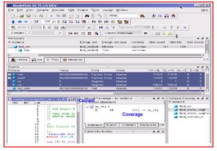

ModelSim用户界面:

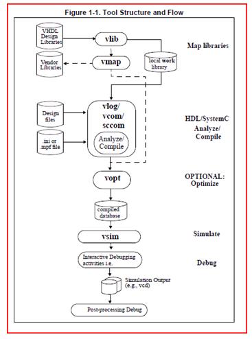

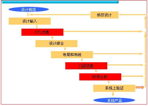

ModelSim设计流程:
ModelSim coverage验证:

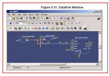

ModelSim Dataflow窗口:

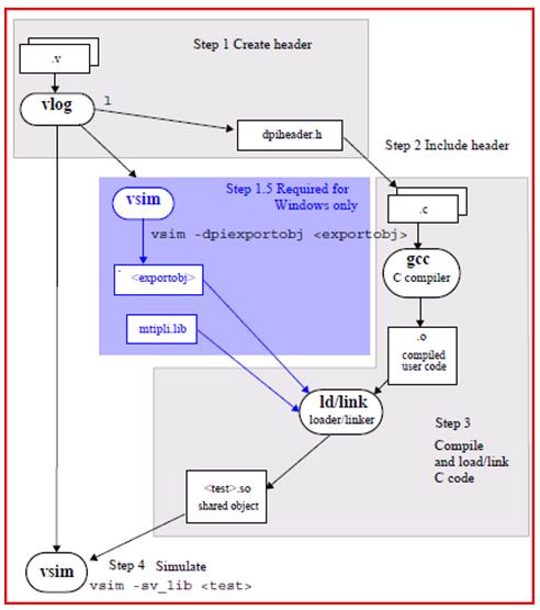

QuestaSim DPI Use Flow:
