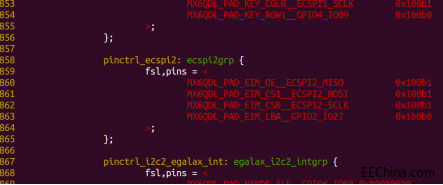

pinctrl_ecspi2: ecspi2grp {
                        fsl,pins = <
                                MX6QDL_PAD_EIM_OE__ECSPI2_MISO          0x100b1
                                MX6QDL_PAD_EIM_CS1__ECSPI2_MOSI         0x100b1
                                MX6QDL_PAD_EIM_CS0__ECSPI2_SCLK         0x100b1
                                MX6QDL_PAD_EIM_LBA__GPIO2_IO27          0x1b0b0
