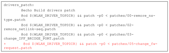

2.3 Modify Makefile.x86
Modify build/scripts/x86-combo/Makefile.x86-combo as bellow
2.4 Apply driver patches
