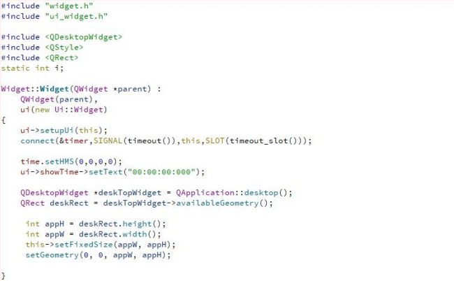

给 QT 程序布局,然后在构造函数添加自动设置屏幕大小的代码。代码如下:
设置好了以后把 qt 代码拷贝到 Ubuntu 上。
#include <QDesktopWidget>
#include <QStyle>
#include <QRect>
QDesktopWidget *deskTopWidget = QApplication::desktop();
QRect deskRect = deskTopWidget->availableGeometry();
int appH = deskRect.height();
int appW = deskRect.width();
this->setFixedSize(appW, appH);
setGeometry(0, 0, appW, appH);
添加完成如下图所示:
