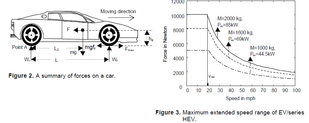

对于HV、PHEV、EREV乃至EV上,电机的选取,在以下的几篇文章之中有了较多的讨论。
1.An Investigation of Electric Motor Drive Characteristics for EV and HEV Propulsion Systems 链接 Z. Rahman, M. Ehsani and K. L. Butler Texas A&M University
2.Electric Motor Drive Selection Issues for HEV Propulsion Systems: A Comparative Study 链接
