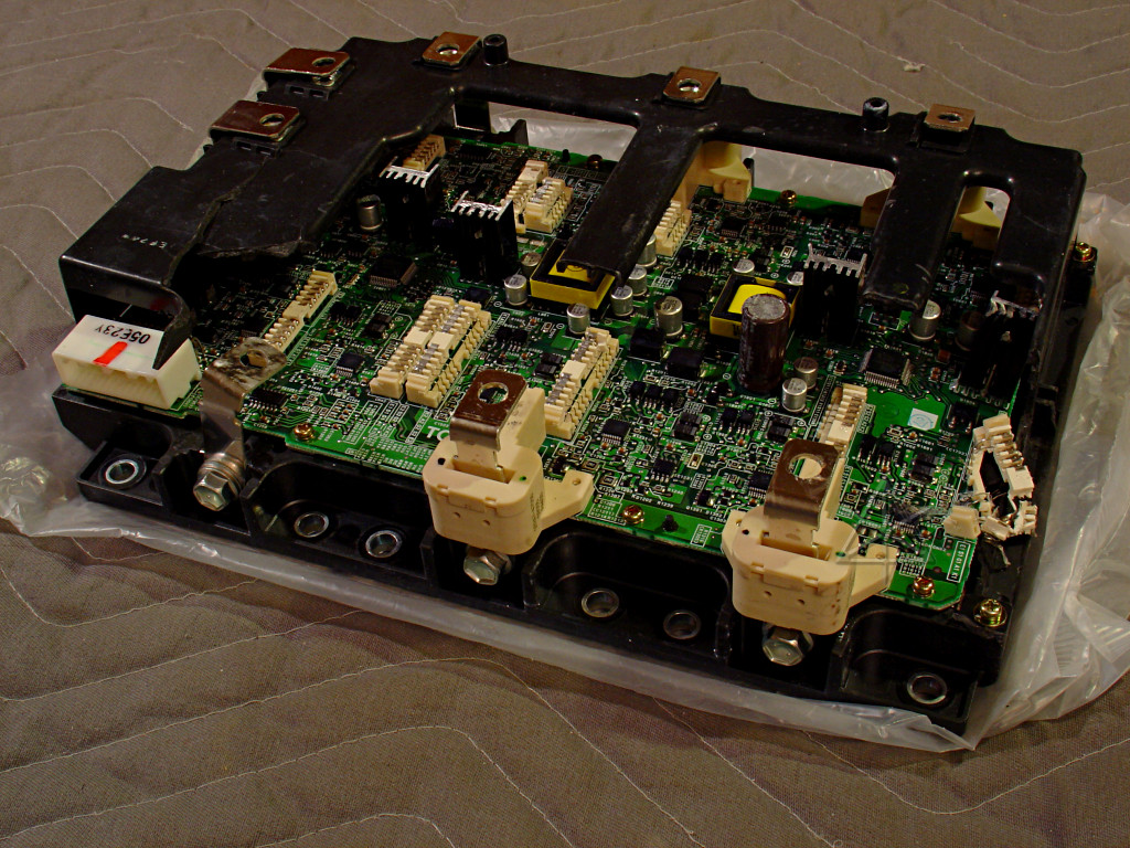

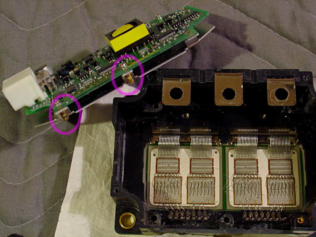

A wonderful opportunity was presented to me -- to have a spare Prius inverter assembly to do whatever I wanted with, and even a few extra bonus modules thrown in. While the technically-astute segments of the Prius owner community are already fairly aware of what's inside these things, having the parts right there to play with and do deeper analysis on adds a whole new dimension of understanding, which I can try to bring to the viewer in as much detail as possible.
Part 0: The package arrives
Part 1: Mechanical disassembly
Part 2: Some component teardown
Part 3: Electrical analysis

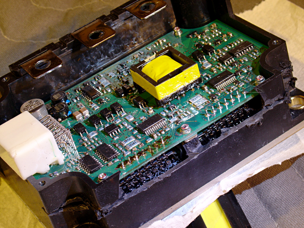

里面我最感兴趣的是这些图片:

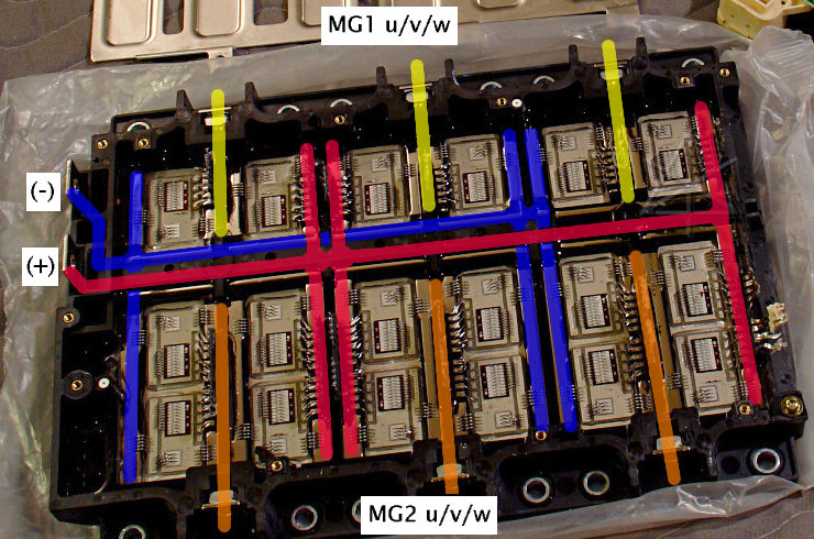

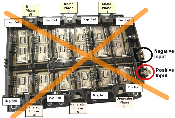

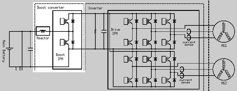

这是系统结构框图,里面关于实际升压器的拆解为:

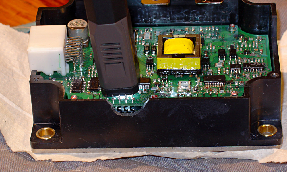

我还真看不出来它的电感是这个样子的,注意电感好像也是分立的,这就能解释能量损耗的释放了:

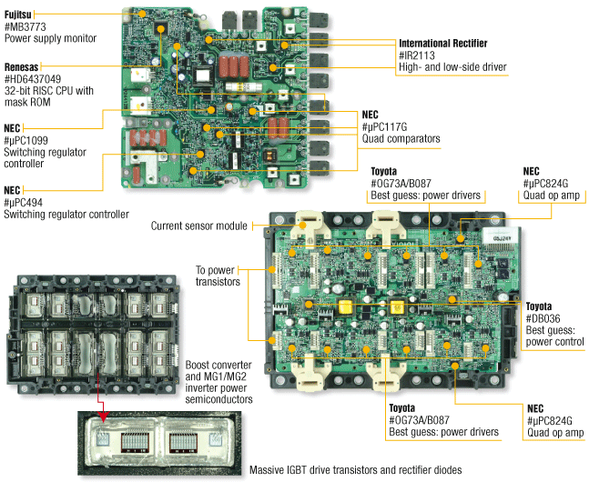

其他关于INVERTER的也是比较全面的拆解:
有张Etimes的图片也不错
