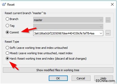

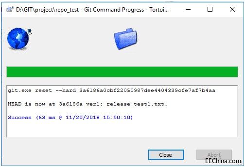

        弹出如下Reset界面,勾选CommitHard:Reset working tree and index(discard all local changes)这两个选项,点击OK 3.jpg
