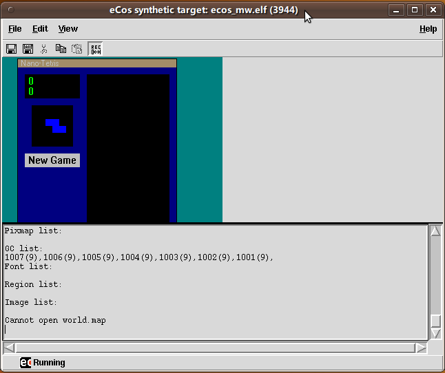

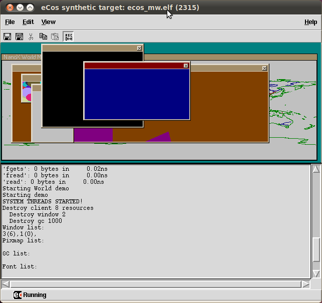

ecosconfig new linux netecosconfig add mwecosconfig treemake
4. 运行synthetic的ecos代码
install/bin/ecos-mw.elf --io

  79. +    case MWPF_TRUECOLOR0888:
  80. +        psi->rmask = 0xFF0000;
  81. +        psi->gmask = 0x00FF00;
  82. +        psi->bmask = 0x0000FF;
  83. +        break;
  84. +    default:
  85. +        printf("%s - unsupported pixtype\n", __FUNCTION__);
  86. +        psi->rmask = 0xff;
  87. +        psi->gmask = 0xff;
  88. +        psi->bmask = 0xff;
  89. +        break;
  90. +    }
  91. +
  92. +    /* Need to figure out better values possibly */
  93. +    psi->xdpcm = 24;    /* assumes screen width of 24 cm */
  94. +    psi->ydpcm = 18;    /* assumes screen height of 18 cm */
  95. +}
  96. +
  97. +static void synth_drawarea(PSD psd, driver_gc_t *gc, int op)
  98. +{
  99. +    diag_printf("synth_drawarea() not implemented\n");
  100. +}
  101. +
  102. +
  103. +/*
  104. + * Initialize memory device with passed parms,
  105. + * select suitable framebuffer subdriver,
  106. + * and set subdriver in memory device.
  107. + */
  108. +MWBOOL synth_mapmemgc(PSD mempsd,MWCOORD w,MWCOORD h,int planes,int bpp,int linelen,
  109. +    int size,void *addr)
  110. +{
  111. +    PSUBDRIVER subdriver;
  112. +
  113. +    /* initialize mem screen driver*/
  114. +    initmemgc(mempsd, w, h, planes, bpp, linelen, size, addr);
  115. +
  116. +    subdriver = &synth_subdriver;
  117. +
  118. +    /* set and initialize subdriver into mem screen driver*/
  119. +    if(!set_subdriver(mempsd, subdriver, TRUE))
  120. +    {
  121. +        diag_printf("set_subdriver() failed\n");
  122. +        return 0;
  123. +    }
  124. +
  125. +    return 1;
  126. +}
  127. diff -r 418d34334c77 packages/services/gfx/mw/current/src/ecos/demo_thread.c
  128. --- /dev/null        Thu Jan 01 00:00:00 1970 +0000
  129. +++ b/packages/services/gfx/mw/current/src/ecos/demo_thread.c        Fri Apr 23 14:41:29 2010 +0800
  130. @@ -0,0 +1,53 @@
  131. +#include      /* which packages are enabled/disabled */
  132. +#ifdef CYGPKG_KERNEL
  133. +# include
  134. +#endif
  135. +#ifdef CYGPKG_LIBC
  136. +# include
  137. +#endif
  138. +#ifdef CYGPKG_IO_SERIAL
  139. +# include
  140. +#endif
  141. +
  142. +#ifndef CYGFUN_KERNEL_API_C
  143. +# error Kernel API must be enabled to build this application
  144. +#endif
  145. +
  146. +#ifndef CYGPKG_LIBC_STDIO
  147. +# error C library standard I/O must be enabled to build this application
  148. +#endif
  149. +
  150. +#ifndef CYGPKG_IO_SERIAL_HALDIAG
  151. +# error I/O HALDIAG pseudo-device driver must be enabled to build this application
  152. +#endif
  153. +
  154. +/* INCLUDES */
  155. +
  156. +#include                       /* printf */
  157. +#include                       /* printf */
  158. +#include                      /* strlen */
  159. +#include             /* All the kernel specific stuff */
  160. +#include
  161. +
  162. +#define MWINCLUDECOLORS
  163. +#include "nano-X.h"
  164. +
  165. +#include
  166. +_mw_app("demo", demo, ECOS_MW_APP_PRIORITY, 0);
  167. +
  168. +//
  169. +// Component interfaces
  170. +//
  171. +
  172. +externC int demo_main(int argc, char *argv[]);
  173. +
  174. +/*static*/ void
  175. +demo_thread(CYG_ADDRWORD data)
  176. +{
  177. +    int argc = 1;
  178. +    char *argv[] = {"demo" };
  179. +
  180. +    cyg_thread_delay(10*100);
  181. +    INIT_PER_THREAD_DATA();
  182. +    demo_main(argc, argv);
  183. +}
  184. diff -r 418d34334c77 packages/services/gfx/mw/current/src/ecos/ecos_app.c
  185. --- a/packages/services/gfx/mw/current/src/ecos/ecos_app.c        Thu Apr 01 13:17:10 2010 +0000
  186. +++ b/packages/services/gfx/mw/current/src/ecos/ecos_app.c        Fri Apr 23 14:41:29 2010 +0800
  187. @@ -115,7 +115,11 @@
  188.      {
  189.          int res;
  190.          printf("... Mounting JFFS2 on "/"\n");
  191. +#ifdef CYGPKG_DEVS_FLASH_SYNTH_V2
  192. +        res = mount( "/dev/flash/0/", "/", "jffs2" );
  193. +#else
  194.          res = mount( CYGDAT_IO_FLASH_BLOCK_DEVICE_NAME_1, "/", "jffs2" );
  195. +#endif
  196.          if (res < 0) {
  197.              printf("Mount "/" failed - res: %d\n", res);
  198.          }
  199. diff -r 418d34334c77 packages/services/gfx/mw/current/src/ecos/nanowm_thread.c
  200. --- a/packages/services/gfx/mw/current/src/ecos/nanowm_thread.c        Thu Apr 01 13:17:10 2010 +0000
  201. +++ b/packages/services/gfx/mw/current/src/ecos/nanowm_thread.c        Fri Apr 23 14:41:29 2010 +0800
  202. @@ -43,7 +43,7 @@
  203. externC int nanowm_main(int argc, char *argv[]);
  204. -static void
  205. +/*static*/ void
  206. nanowm_thread(CYG_ADDRWORD data)
  207. {
  208.      int argc = 0;
  209. diff -r 418d34334c77 packages/services/gfx/mw/current/src/ecos/nanox_thread.c
  210. --- a/packages/services/gfx/mw/current/src/ecos/nanox_thread.c        Thu Apr 01 13:17:10 2010 +0000
  211. +++ b/packages/services/gfx/mw/current/src/ecos/nanox_thread.c        Fri Apr 23 14:41:29 2010 +0800
  212. @@ -41,7 +41,7 @@
  213. externC int nanox_main(int argc, char *argv[]);
  214. -static void
  215. +/*static*/ void
  216. nanox_thread(CYG_ADDRWORD data)
  217. {
  218.      int argc = 0;
  219. diff -r 418d34334c77 packages/services/gfx/mw/current/src/ecos/ntetris_thread.c
  220. --- a/packages/services/gfx/mw/current/src/ecos/ntetris_thread.c        Thu Apr 01 13:17:10 2010 +0000
  221. +++ b/packages/services/gfx/mw/current/src/ecos/ntetris_thread.c        Fri Apr 23 14:41:29 2010 +0800
  222. @@ -41,7 +41,7 @@
  223. externC int ntetris_main(int argc, char *argv[]);
  224. -static void
  225. +/*static*/ void
  226. ntetris_thread(CYG_ADDRWORD data)
  227. {
  228.      int argc = 1;
  229. diff -r 418d34334c77 packages/services/gfx/mw/current/src/ecos/world_thread.c
  230. --- a/packages/services/gfx/mw/current/src/ecos/world_thread.c        Thu Apr 01 13:17:10 2010 +0000
  231. +++ b/packages/services/gfx/mw/current/src/ecos/world_thread.c        Fri Apr 23 14:41:29 2010 +0800
  232. @@ -41,7 +41,7 @@
  233. externC int world_main(int argc, char *argv[]);
  234. -static void
  235. +/*static*/ void
  236. world_thread(CYG_ADDRWORD data)
  237. {
  238.      int argc = 1;
  239. diff -r 418d34334c77 packages/services/gfx/mw/current/src/nanox/srvmain.c
  240. --- a/packages/services/gfx/mw/current/src/nanox/srvmain.c        Thu Apr 01 13:17:10 2010 +0000
  241. +++ b/packages/services/gfx/mw/current/src/nanox/srvmain.c        Fri Apr 23 14:41:29 2010 +0800
  242. @@ -47,6 +47,7 @@
  243. # include
  244. # ifdef CYGPKG_NET
  245. #  define NONETWORK 0
  246. +#  define MW_NOSIGNALS 1
  247. # else
  248. #  error Not yet supported.
  249. #  define NONETWORK 1
  250. @@ -725,9 +726,11 @@
  251.         selection_owner.typelist = NULL;
  252. #if !NONETWORK
  253. +#ifndef MW_NOSIGNALS
  254.         /* ignore pipe signal, sent when clients exit*/
  255.         signal(SIGPIPE, SIG_IGN);
  256.         signal(SIGHUP, SIG_IGN);
  257. +#endif
  258.         if (GsOpenSocket() < 0) {
  259.                 EPRINTF("Cannot bind to named socket\n");
复制代码
